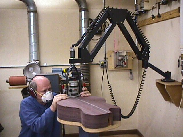

I would like to buy a jig for routing binding/purfling... if you have a favorite that is available, that I don't have to actually build, please do tell. If a special/particular router/laminate trimmer is needed let me know as well. I have a Makita laminate trimmer if that would suffice. Thanks again for all of your help.

Look at the Jig section and the Don Williams binding jig. I forget who but someone is producing and sellin this system
PostPosted: Tue Dec 27, 2005 8:54 am
Craig Holden makes a wonderful jig for cutting binding/purfling ledges based on the Fleischmann/Williams design. You will need a rabbet & bearing set from StewMac or LMI to use with it, unless you modify the unit per Dave White to utilize a spiral bit.

Mark at www.guitarjigs.com has a great jig. You can find info on his site and your Makita trimmer would work perfect with it (it is what I use). I am really happy with this jig.

Greg, John Hall at Blues Creek Guitars (check sponsor links) also sells a pre-built binding jig. It is the Tom Ribbecke designed jig which is also sold by LMI.
PostPosted: Tue Dec 27, 2005 10:47 am
Posts: 1542
     The 3 designs mentioned here all do the same thing but approach it from different angles. While I prefer simplicity the williams design is more compicated but all work on the pricipal of keeping the bit parallel to the sides while cutting the channel. Craig does good work and both of us produce quality stuff. You need to make your own mind to which is best for your system.
     The williams and ribekke design use a carrage for the body and one you rotate the body the other you let the router go around.
       Ribekke's design was intended that way in the beginning but works better with the router post secured and the body roated. Either way I feel the best results will come using a good piloted bit system. I use and recommend the stew mac 1298. It don't get no better
john hall
blues creek guitars.
PostPosted: Tue Dec 27, 2005 11:56 am
Posts: 1533
Location: Morral, OH
I will cast another vote for Mark Kett's jig. The difference with his jig and the others is that his indexes off of the sides whereas the others index off of the top and back planes. Martin and Taylor both used systems that employ the same principles as Mark's.

I personally like Jim Olson's jig and think I may build something like it one day.

Greg, that's how it works but it's still quite precise. I have shown pictures of my humble little version of this jig here before, check this discussion out (pictures towards the end):
binding jig
Pros: Adjustable for both width and height, any cutter can be used (down cut spirals work great), simple, cheap, small
Cons: Cut must be tested on scrap!
I saw a similar jig in use at the Martin Factory; they turned the guitar bodies around a stationary jig. Julius Borges has pictures of a jig that looks a lot like it on his web site as well. I don't know how it compares to the other more elaborate jigs mentioned here as I haven't tried them, all I know this works well.
